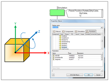

The image to the right shows a cube with it's axis positions identified.
Calling the simulation api Panel.Position.RotateZ(MyCube,MyCube,1) will rotate the object in one-degree steps along it's Z-axis as shown by the blue rotation arc. To rotate the cube in a counter direction simply specify a negative number for the degrees parameter.

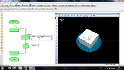

The screenshot from Flowcode v6 below shows a cuboid with it's internal axis shown (blue is the Z-axis line), and also a circle that cuts right through the cuboid's Z-axis (see example section below for links to the file) When the program runs the cuboid rotates along it's Z axis.
