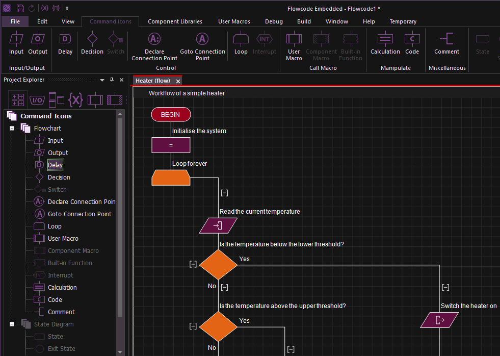

Blueprints are a new feature introduced in Flowcode v11.0.1 which allow a simple high-level flowchart to be created within a Flowcode project.
Blueprints work in a similar way to normal Flowcode macros but have no code associated with them and cannot be simulated or compiled into a working program. They can be viewed as a flowchart and as pseudocode and use a subset of the normal flowchart icons.
Typically these can be used to describe a process or workflow associated with the Flowcode project or to be the starting point for creating a new code macro.
