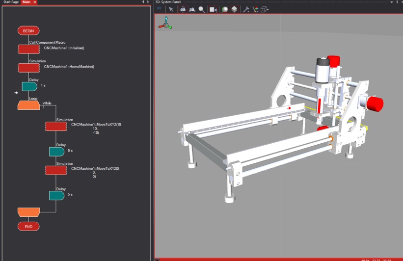

Working Example
Below is a working example for example 1, which initialises, then homes the machine and finally features a loop which moves the machine head between coordinates (0,0,0) and (10,10,-10).
CNC Machine - Worksheet 1
