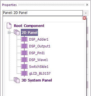

The branches of the tree / children of the panel can be viewed by clicking the drop down selection at the top of the Properties Panel window.

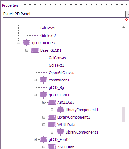

Using the Component Debugger window you can look further inside the tree by enabling the ‘Expose full component tree in property pane’ option. This can be used to explore the component's child components and properties packaged up within the component.
The branches of the tree in our project now look like this.

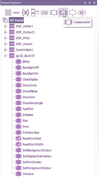

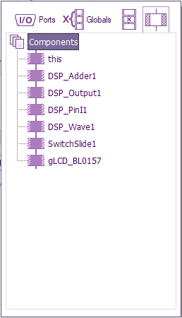

The component object variables can be seen by using the components tab of the Project Explorer window.
When calling a simulation API command you may need to refer to the 'this' node of the tree, the ‘this’ variable can be typed in manually or is available from the component object list featured within the Calculation, Component Macro, Simulation and Macro flowchart icons.
