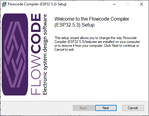

Right-click on the file and select install you will see:
Click Next

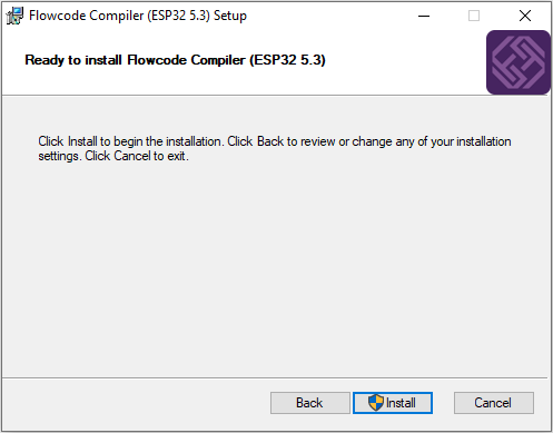

After clicking on Next you will need to click on Install, which will require Administration rights

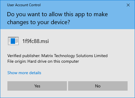

There will be a User Account elevated prompt, which you will need to select Yes

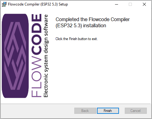

The ESP32 Toolchain will now be installed.
Finally, click on Finish

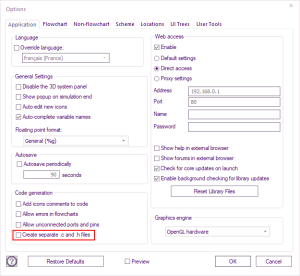

When using the ESP32 toolchain in a multiuser environment, it is important that Flowcode is set to create a single .c file instead of using separate .c and .h files. This setting can be found in the “Application” tab of Flowcode’s “Global Options” and needs to be unticked for each user as shown in the image.
Note that the default setting is for this to be ticked. This setting is controlled by the following per-user registry key and IT administrators may find it more convenient to set the following key for all users during the installation of Flowcode:
- [HKEY_CURRENT_USER\SOFTWARE\MatrixTSL\FlowcodeV10\Options\compilation]
- "SeparateHeader"=dword:00000000
