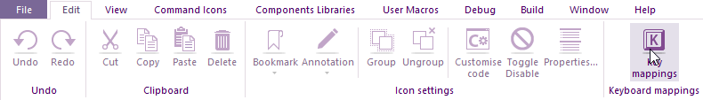

To set up or change key mappings, select the Key Mappings option from the Edit menu (Edit > Key Mappings...). For each key you can either enter an expression

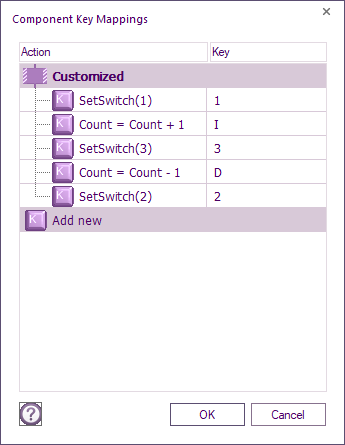

Or enter the name of a user macro and the keyboard key within brackets and the Parameter value will be passed - See the Flowcode example below.
Key
The key-combination that you wish to map. This may be any alphabetic or numeric key, optionally combined with Alt, Shift or Control.
Action
This can be any calculation line for your flowchart or a user macro call.
Example
Here is a simple example showing key mappings in simulation.
Keyboard keys pressed:
1 = Toggle Switch1
2 = Toggle Switch2
3 = Toggle Switch3
I = Increment Count variable
D = Decrement Count variable
