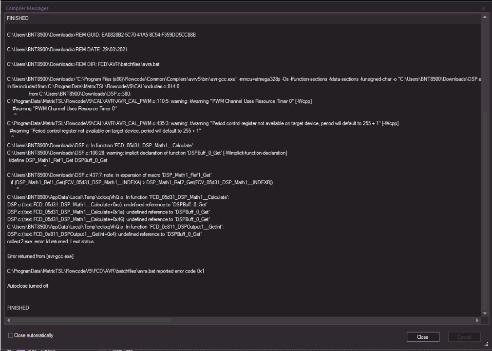

hi
I'm traying to replicate the same thing with an arduino uno
but i get this error( see attachement)
what do i wrong?
kind regards
what do i wrong?
kind regards
- dsp.fcfx
- (15.82 KiB) Downloaded 399 times
- error
- foutmeldig_dsp.jpg (103.43 KiB) Viewed 4617 times
- Posts: 1940
- Has thanked: 506 times
- Been thanked: 689 times
Re: DSP Components - An introduction
Please can you try going to Help -> Library Updates, Then change the Files in use setting at the bottom of the window to Full Database. This should download some new files and after reloading your project hopefully it will all compile ok for you now.
One thing I did notice is the DSPWaveGen componnent Calculate Data property is currently generating a compile error when set to Yes so I'm going to try and investigate this for you now. edit - this should also be fixed now too.

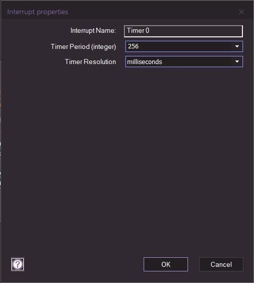

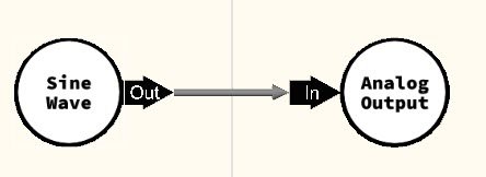

In your video everything works so simply but..
I tried to control the DAC of the ESP32 with the DSP.
Even on the beginn with the setting of the interrupt is not clear to me how that works.
At the end there should be a sinus signal of about 1 kHz on the DAC output, so a 10 kHz interrupt frequency would be good.
And as soon as I turn on the interrupt, the program crashes
how to set to 10khz
Simple dsp function:
how to set to 10khz
