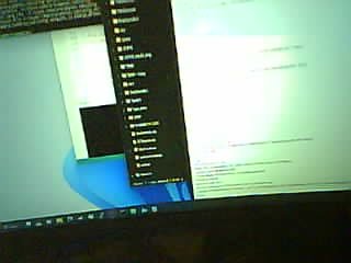

Post by mnfisher »
Hi Ben,
Just got my first JPEG saved :-) After a lot of fiddling.
Hit upon the snag of the SD card not being supported (?) on the camera board - so had to pull in some more espressif code...
Still - got there - next try upping res to UXGA
