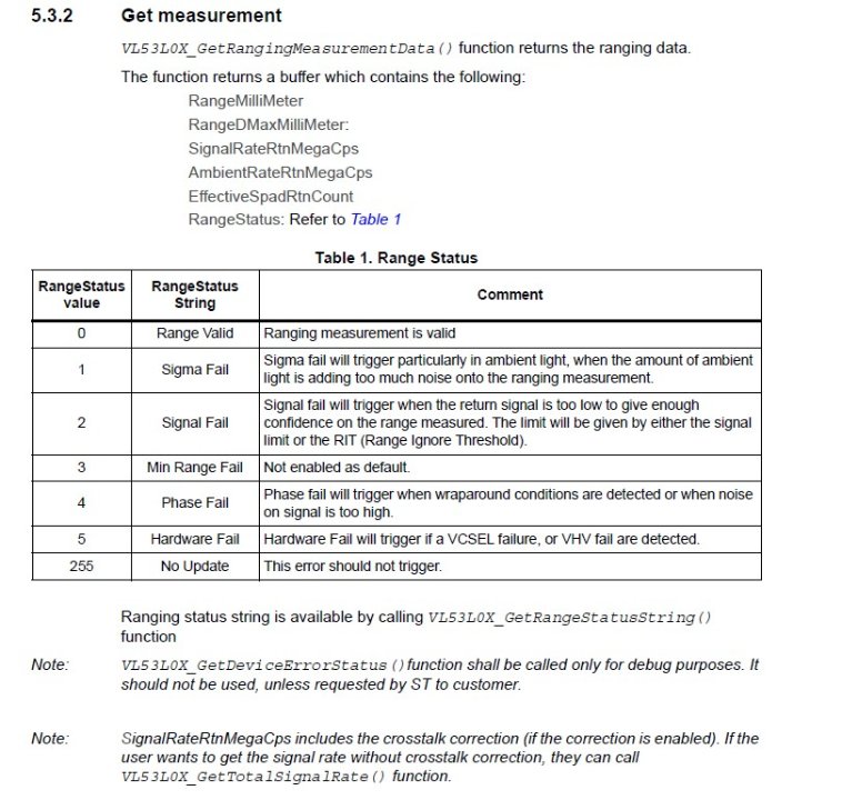

After checking the VL53L0X component and C code, it seams that RangeStatus and others below not used too
RangeMilliMeter
RangeDMaxMilliMeter
SignalRateRtnMegaCps
AmbientRateRtnMegaCps
EffectiveSpadRtnCount
Rangestatus is used to check if the measurement is valid or not .
it's a very important to know if value can be used or not and also because there is "radar aliasing".
Basically the light from flash N comes back after flash N+1, and an object at a far distance, looks near. So if rangeStatus is equal to 4 mean that measure is wrong.
1 - Could you add a component Macro to be able to read the range status register after a read distance and add it in a variable
like this, programmer could be able to use it or not
RangeStatus is from VL53L0X_GetRangingMeasurementData() . (may be register 0x0014 but not sure for RangeSatus )
https://www.st.com/resource/en/user_man ... ronics.pdf
2- please also add component macro to be able to get the data below at each reading if programmer want to use it
they are all from VL53L0X_GetRangingMeasurementData()
RangeMilliMeter
RangeDMaxMilliMeter
3- add on component the ways to choose default mode or Single Ranging high Accuracy or Single Ranging High speed or Single Ranging Long range
If I can get Rangestatus function first, it will be very good to be able to use the TOF and be sure of the measure
Currently I saw that there is aliasing (and an object at a far distance, looks near)

Hi Martin,mnfisher wrote: ↑Thu Apr 13, 2023 6:59 amI didn't have much success - reading the register at 0x14 seemed to consistently return the same value (91) - even with something placed on the sensor?
The documentation for the chip isn't great - but I had a quick look at the API code. Some more digging needed.
I did some test and read register from 0x14 to 0x1F, just after a measure
0x14 return 91,33,49,65, 79, 95, etc... this depend of the status result.
Then need to make the calculation:
RangeStatus = RangeStatus >> 6 //RangeStatus is the return value when read register 0x14 just after a measure
-when 0x14 returne value is 91 , after calculation the result is 11 --> Range complete (measure is ok)
-when 0x14 returne value is 33 , after calculation the result is 4 --> No Target
etc...
Do you know what are register 0x15 who return always 6, 0x18 and 0x19 ?
see excel file on PM.
do not ask me how I found these registers and how to calculate, It take so long search and time !!!!
Seb
