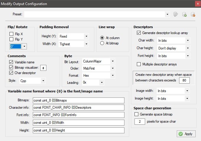

Saying this we can create the font data using a tool called The dot factory - http://www.eran.io/the-dot-factory-an-l ... generator/
For the input string I use this data to create the printable ASCII characters between 33 and 126. This is a full font set, of course you can pick and choose which characters are included.
!"#$%&'()*+,-./0123456789:;<=>?@ABCDEFGHIJKLMNOPQRSTUVWXYZ[\]^_`abcdefghijklmnopqrstuvwxyz{|}~
For the configuration settings I use these.
On clicking generate it creates three arrays.
The first is the bitmap pixel data. This would become your main data array.
The second contains the width of the character and the byte offset in the bitmap pixel data. This with some manipulation would become your width array.
The third is some stats such as pixel height. This would be used to configure some of the properties.
For use with the existing font component you need to do a bit of manipulation specifically to array 2 to remove the byte addresses. You will also need to remove the comments by turning these off in the dot factory options. edit - It doesn't look like turning this off makes a difference so the comments will need to be manually removed.

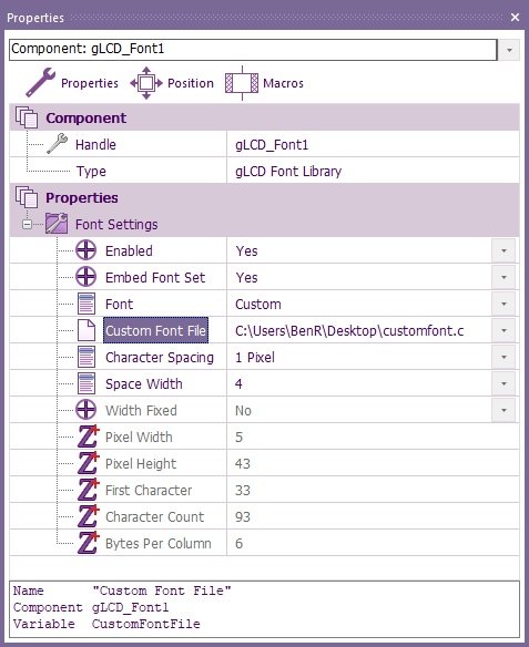

Right I've not had time to test this in action but it looks to be working and should allow you to point Flowcode at the dot factory .c file output directly.
First go to library updates and get the latest Font component, then restart Flowcode.
Next in your display properties set the font to custom, it should be right at the bottom of the list.

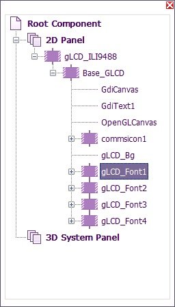

Finally go to View and Component Debugger and then enable Expose Full Component tree.
In the drop down at the top of the properties window select the Font component inside the GLCD_BASE that has the custom font selected.
Change the Custom Font File property to point to the unedited dot factory .c file.
Fingers crossed that should all work and this should both simulate and download to target.
