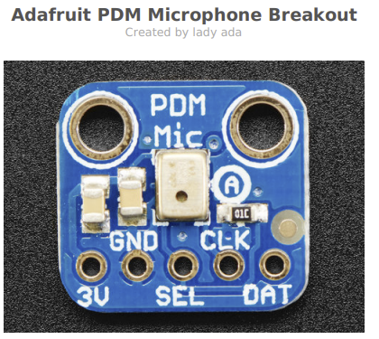

What about a component for a PDM microphone?
There are many small, inexpensive PDM microphones . These are available for smd soldering, as a small board or built into a housing with a groove connector. Sometimes you can find these PDM microphones on many ESP32 demo boards.
Here from Adafruit with groove connector

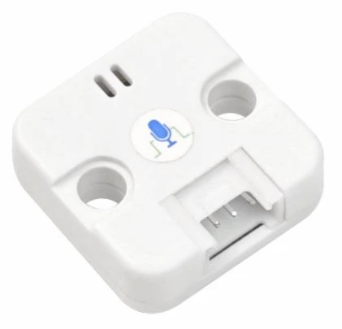

Or the Mic in a Case with groove connector ( U089 with SPM1423HM4H-B)
