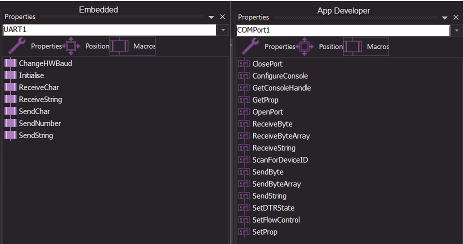

I saw how comfortable the comport from the App Developer is. Sending receiving byte array looks great.
Is it possible to have the same in the Embedded for the uart. So that it match together.

Hi Stefan,
Yes good suggestion I have now upgraded the UART component for you with a few more hopefully useful functions.
It can now send and receive: strings, arrays, ASCII decimal, ASCII hexadecimal, ASCII float, 8-Bit Binary, 16-Bit Binary, 32-Bit Binary and 32-Bit Floating point Binary.
I'll see if I can add the additional functions to the COM port component as well as they should hopefully prove quite useful.

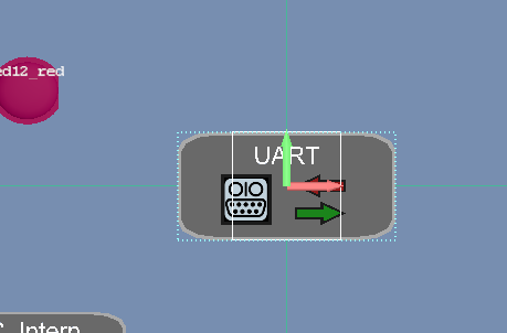

As soon as I slide the uart into the 2D panel, I get an error.
But in the App Developper it seems to work.
