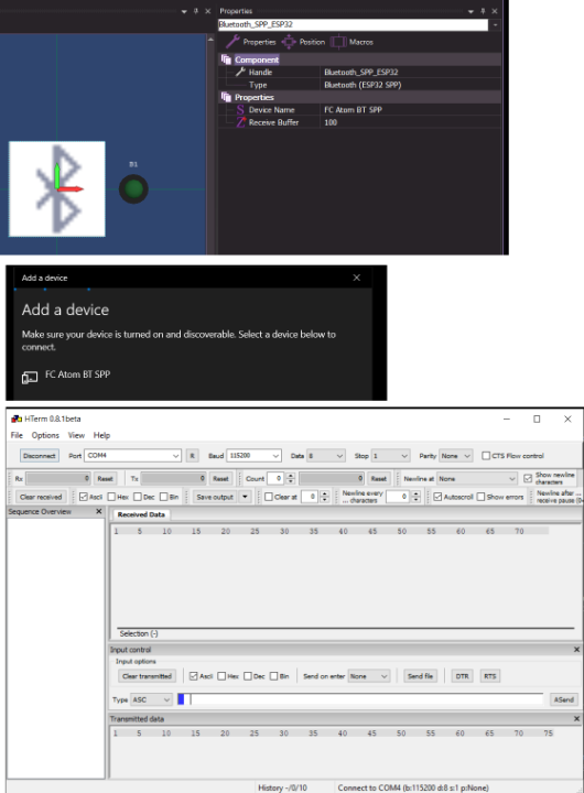

It's working again with the M5 Atom board.
But I don't know why.
I guess, because every time I rename the program or copy it to another folder I have to redefine the two lines in the sdkconfig file.
On this occasion I would like to mention the simple drag and drop of Flowcode for ESP32 Bluetooth. You don't need a pin or baud rate and you never confuse about rx and tx pin. And simple to choose a Bt name. Also to check if it's connected is so easy.
