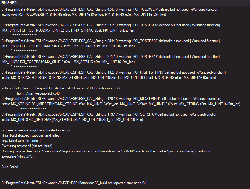

Right sorry the last file didn't work, it caused a compile error. However I think I may have gotten somewhere with this now.
Copy the attached file into your "C:\ProgramData\MatrixTSL\FlowcodeV9\CAL\ESP" folder and hopefully when you compile your project the problem will go away.

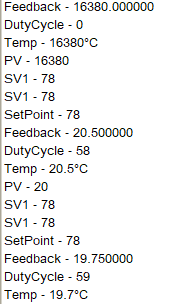

It is still not working the problem is still the same wont work with multiple instances of a SPI
When I initialize before the gLCD initialize the screen works but second SPI component stops.
UART Debug.png (3.97 KiB) Viewed 8188 times
