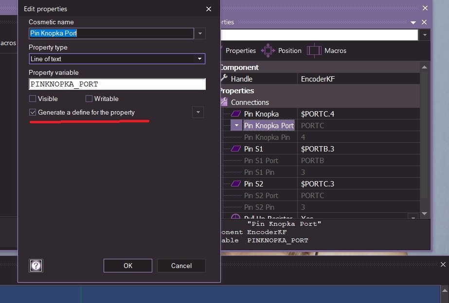

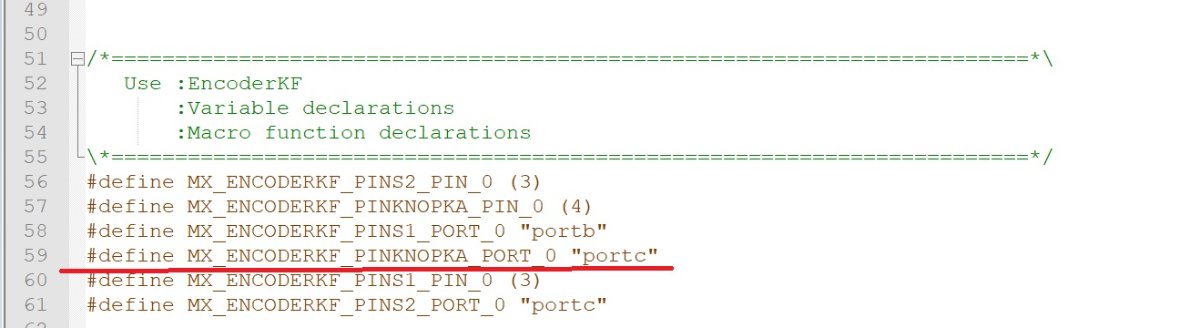

I want to make a component that uses a property and for this property I ticked "Generate a define for the property". When compiled into C code, this property appears in quotation marks. How do I remove quotes when compiling to C code?

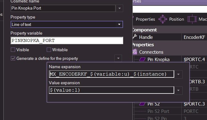

The property type ‘line of text’ causes the quotes.

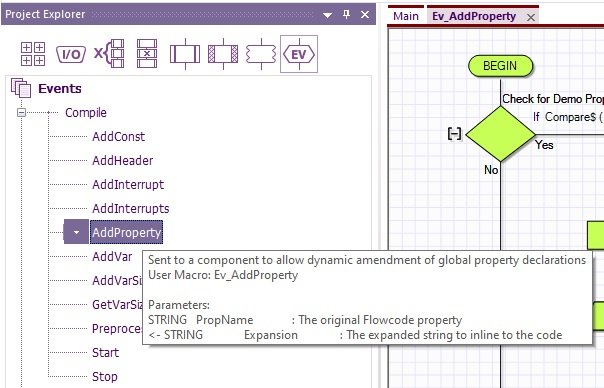

I've created a demo for you where I remove the quote marks using an Compile -> AddProperty event macro.
Hopefully it should do everything you need it to do.

Results in this being generated in the C code.
#define MX_ENCODERKF_DEMO_0 portc
