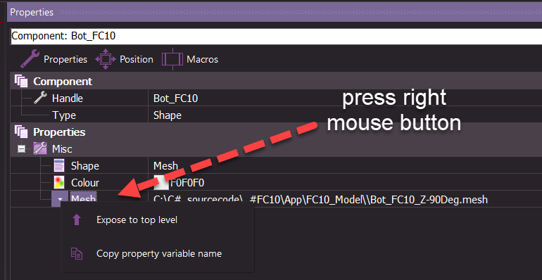

On my App I have 2 shape as mesh and I set the propertie mesh to " Expose to top level"
It's working perfect even in the deployd App version.
So I (the user also) can change the shape (mesh) while runing the App. Suport with a browsing to get the new mesh for each shape it's working perfect.

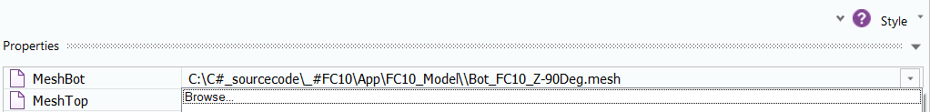

Example mesh file choose in running App:
Set properti mesh to top as meshtop and meshbot
In the deploid App choose via browser a new mesh file
