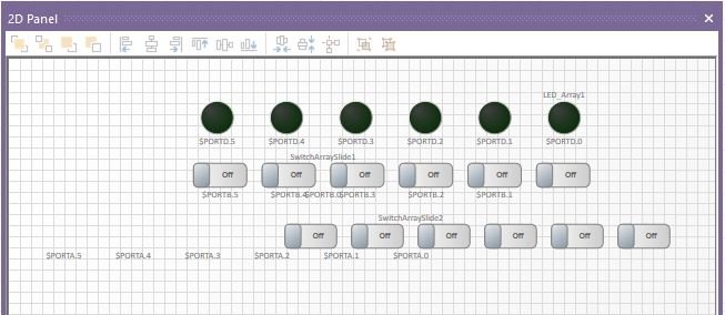

When using the Switch Array (Slide) 2D, when resizing to say 6-positions, the text screws up a bit

Re: Resizing Switch Arrays
Following on from above, I was using latest FC on W8.1
I tried on my W10 machine running 10.0.0.14 and things were fine
I then updated the W10 to latest (inc libraries) and the problem returned.
EDIT...
As per advice another post earlier in the week, I deleted my FC10 folder on my W8.1 forcing FC to download latest, problem persists
EDIT...
Further to above, once closed and reopened I can't select the array unless I click outside the switch area and "drag" a rectangle across to capture.

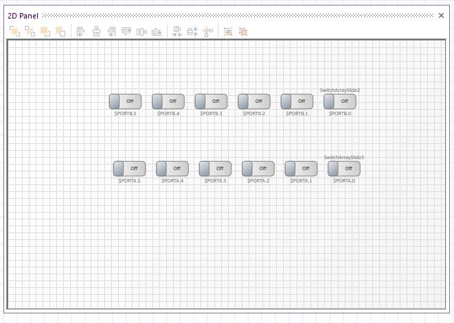

Hi.
Would you like to try the attached components and see if they are better for you?
Just for anyone that does not know.
If you would like to try the component before the updates are pushed.
Browse to this location using file explorer, it's hidden by default so just paste the link into your address bar.
Replace the existing files with the attached files.
If you run any component updates, then the components you added will be overwritten
C:\ProgramData\MatrixTSL\FlowcodeV10\ComponentsIf Flowcode is already open, then you will need to reload your project for the new components to work
