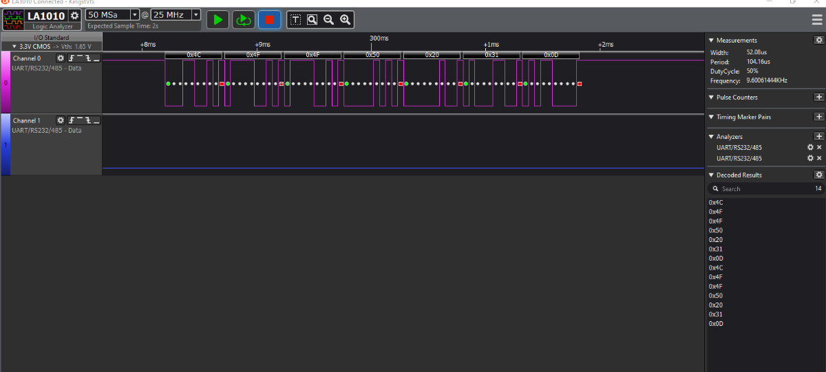

- proof that avr is sending message
- logic_send loop1.PNG (94.45 KiB) Viewed 3631 times

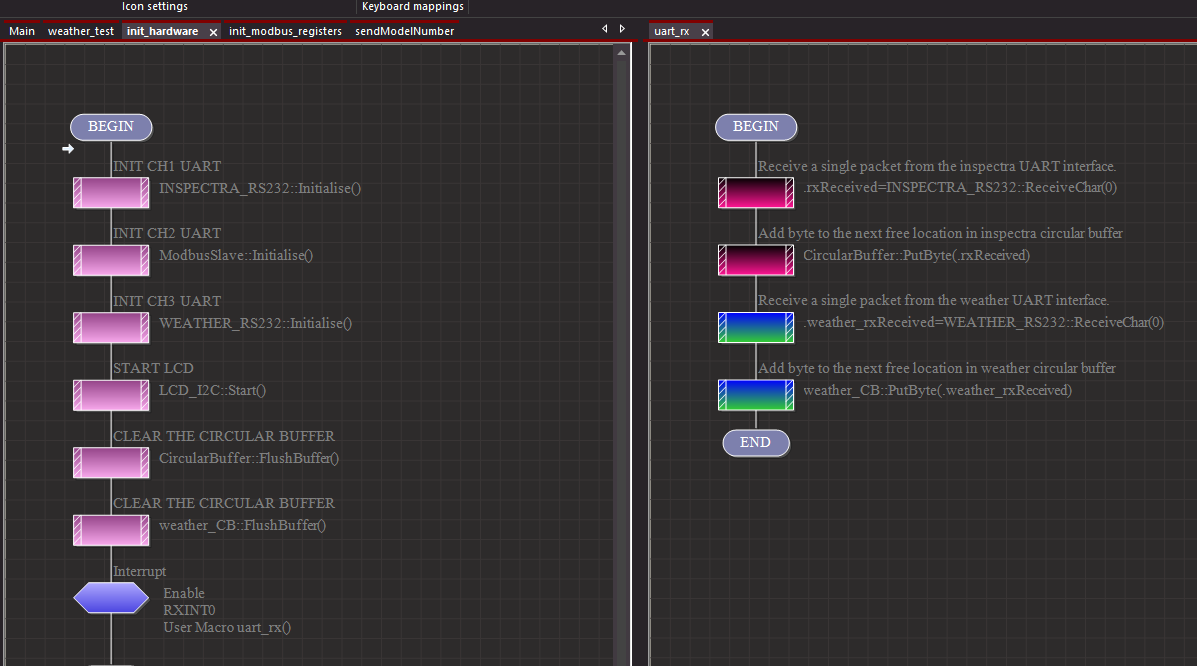

Re: add a second circular buffer?
Hi so if I understand correctly I should not do what I did below? I need to make an RXINT2 since FC does not have one made for me to use. Is there a way I can reverse engineer RXINT1 or RXINT0 so I can make an RXINT2?

- rxUART.PNG (128.74 KiB) Viewed 3619 times
