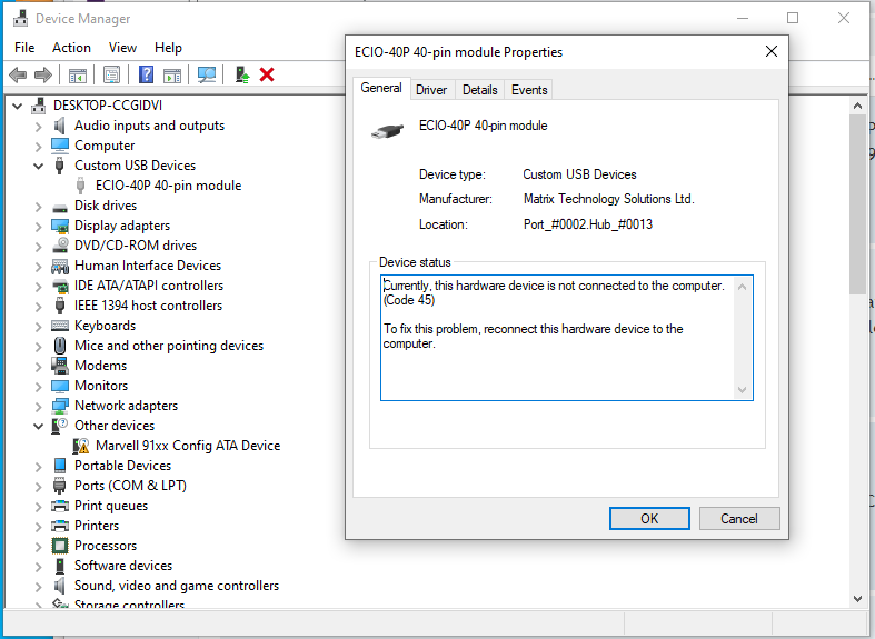

First issue ?
plugging in my ECIO to check windows detected it :-
Have tried a different port and get the same message.
Have tried the same lead on my electronic load and it works ok.

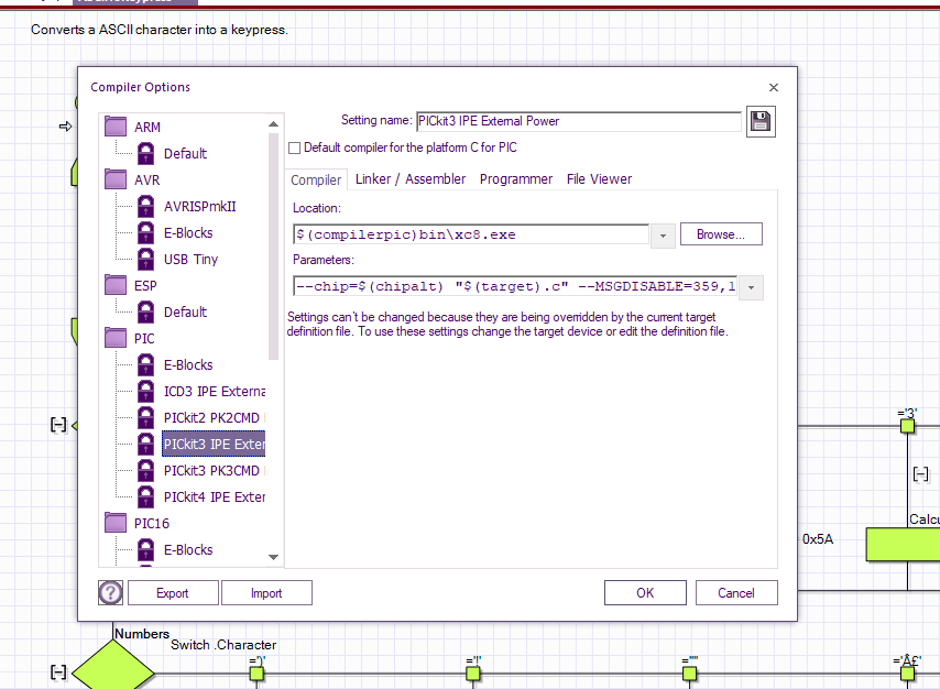

So i thought maybe because flowcode not open, so i opened it
When i checked the project options to try and change to mloader as my default is a pickit3 - was greeted by this message :-

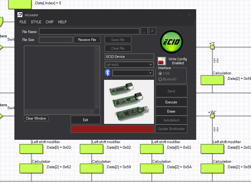

My ECIO is set to USB Power on the Link & the green led flashes
running mloader i get this but forget what to do next, seams like everything knows its there
Any idea's

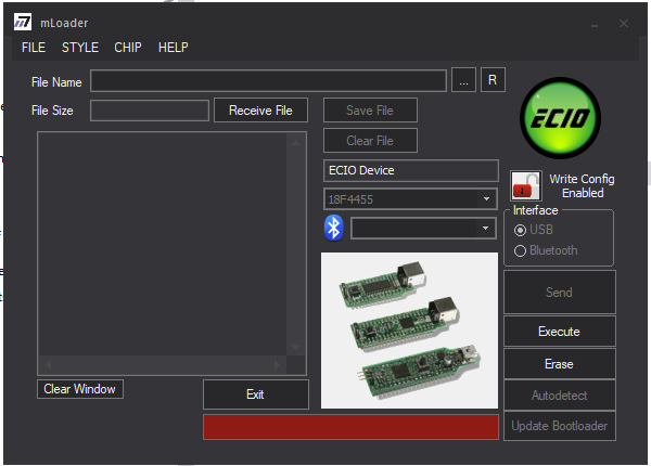

at the moment mloader is seeing the ECIO and the LED is flashing (dose this mean its connected to mloader) ?
Device manager is showing it the ECIO logo is green
