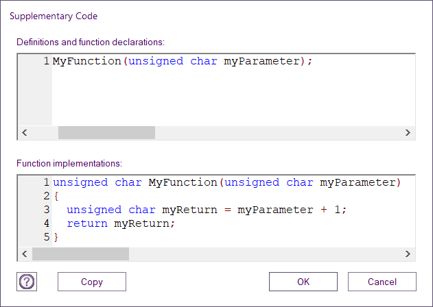

It is possible, but C code icons within the flowcharts in Flowcode are not ideally suited to contain full C functions. A better place to store functions within "supplementary code" (under Build->Project Options). You can then call these functions from your flowchart using a C code icon.
I also notice you are using variable names within your C code that start with "FCV_". I would avoid this because they could clash or cause confusion with variables created within Flowcode. In your own C functions you should use 'normal' variable names rather than the names of Flowcode variables. The exception is when you want to refer to Flowcode variables within your C code (e.g. when passing Flowcode variables to your functions).
I have attached a simple example project of using Supplementary Code within Flowcode. And here are some images from the example.
Supplementary Code Example.png (23.63 KiB) Viewed 5302 times
