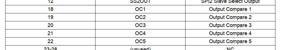

These are the lines that handle the remapping.
#define MX_PWM_RPOR_1 RPOR1bits.RP3R
#define MX_PWM_RPOC_1 18
Here are the PWM channels

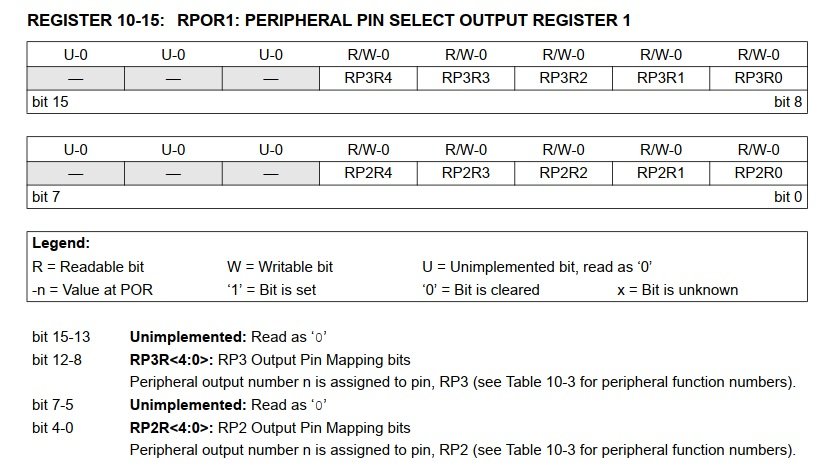

Here are the output register bits, showing RP2R and RP3R inside register RPOR1.

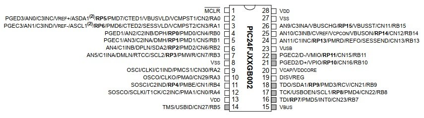

And finally the RP pin assignment
