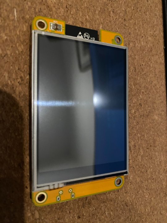

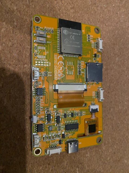

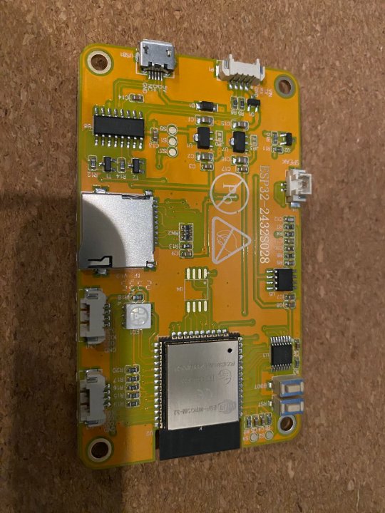

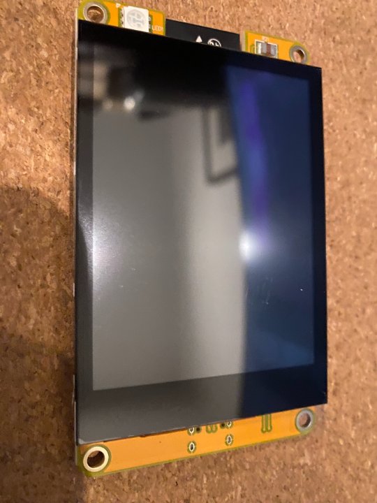

here are some pictures of the boards.
Thanks all.

From what I see they use an ESP-WROOM-32 chip which is supported in FC, and also the display seems to be based on the ILI9341 (SPI) which is again supported in FC.
I don't seem to see any reference to the Touch Screen though, but perhaps the generic resistive one could be used?
You would need to establish what pins on the WROOM are used to communicate with the display, and then set the FC display component to the same. Similarly if you can establish the pins for the Touch Screen set the FC component to the same.
