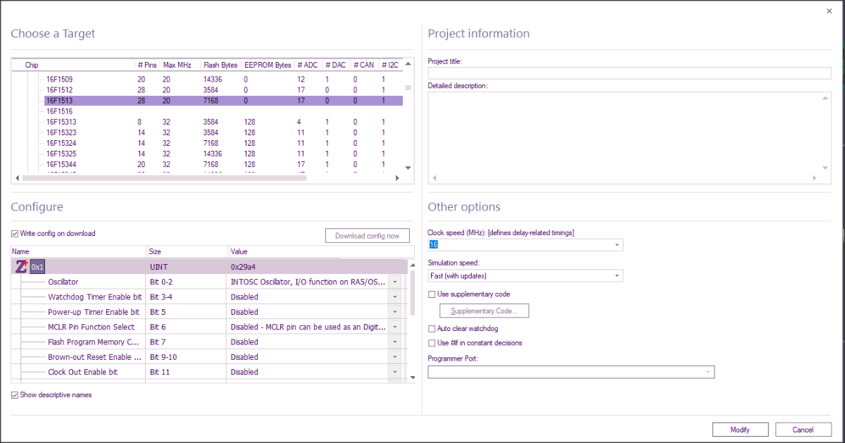

Re: PIC16F15xx Family support
Unfortunately it didn't happen. I guess the CRC isn't the only protection.
Would you like to try this fcdx file?
Browse to this location using File Explorer, it's hidden by default so just paste the link into your address bar.
If Flowcode is already open, then you will need to reload your project.
If you run any component updates, then the fcdx you added will be overwritten.
Note: you won't see any data within the fields when selecting 16F1516.
C:\ProgramData\MatrixTSL\FlowcodeV9\FCD\PIC\If you run any component updates, then the fcdx you added will be overwritten.
- 16F1516.fcdx
- (18.3 KiB) Downloaded 748 times
Currently the code is working properly. Thank you for your quick support.
I just noticed that the following line is different, will this cause a problem in the future?
You're welcome.
I have not edited that line.
The one you are comparing with is from a much older version of Flowcode.
The fcdx file I posted is for FC9.
You're welcome.
