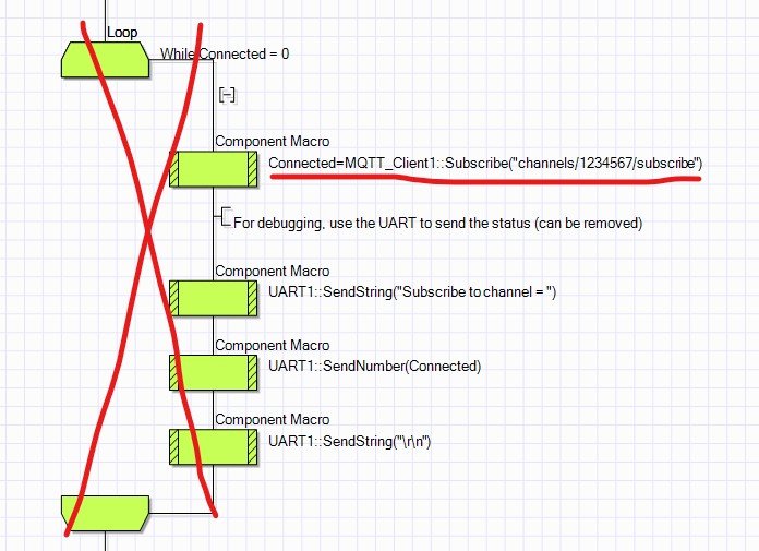

I did a test without "subscribe component macro" and it work well too.
No need to subscribe before to publish data.
no need.jpg (67.44 KiB) Viewed 26566 times

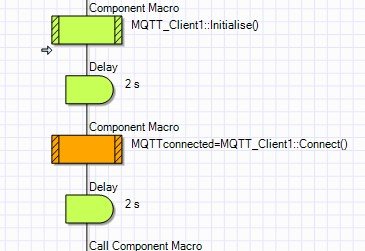

second point, I add initialise MQTT before to connect
Delay can be adjusted
Seb
