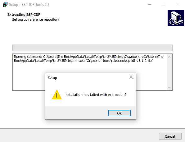

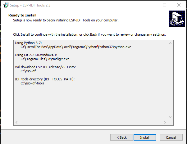

I have been trying to install, for the last few weeks now, the ESP toolchain with no luck. before i completely loose it, i though id see if anyone else has encountered the same issue as i've seen on the forum and online throughout my searching, it hasn't been issue free for most.
the issue mainly is that its not completing the install. always finishing with an error 'exit code -2'.
I have uninstalled and installed the IDF many times throughout trying and its always produced an error. using both the flowcode supplied 2.3.exe, and espressif.com downloaded .exes (various online and offline .exes, with different idf versions), all with no luck.
see the error screenshots and logfile below.
Any pointer would be highly greatful.

First thing I would do is use a username without spaces so your folder names do not contain spaces. Second, search the forum for the detailed instructions that have helped other users. You aren’t the first with issues with the toolchain and won’t be the last, however there is a wealth of information in the topic where other users have similar problems.

I agree with kersing, according to the log, the space in the username does seem to be causing problems

It looks like it was the spaces. i assumed the space issue was something just for the original destination path of the installed files that was inputed at the start of the installer, rather than the use of the various installer, downloader and extractor scripts within the .exe and its interaction with any path with a space. im yet to use it to see if it works using flowcode, but the original issue of the exit code before the install finished, i no longer have and has successfully installed.
