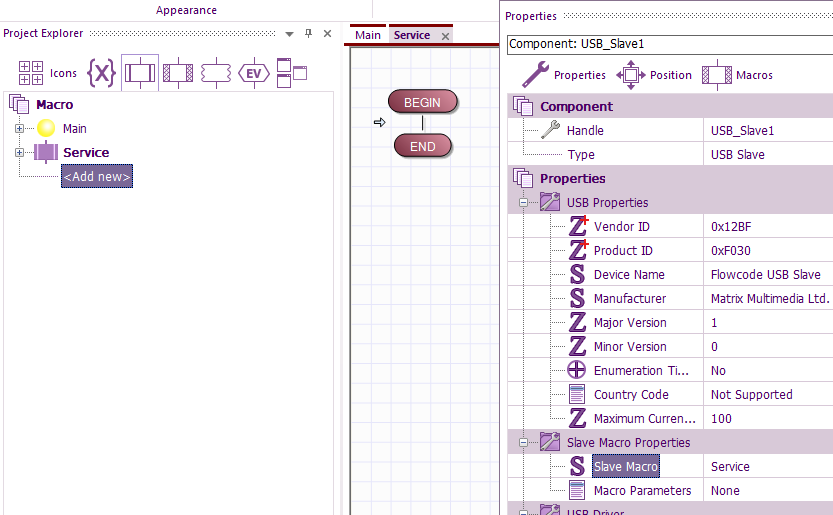

Do you want to try this and see how you get on. The USB serial component was failing to add for me so I've re-exported it and pushed the latest to the Help -> Library updates.
The USB slave component requires you populate the Slave Macro property with a valid name of one of your Flowcode macros. Here I've created a macro called Service.
