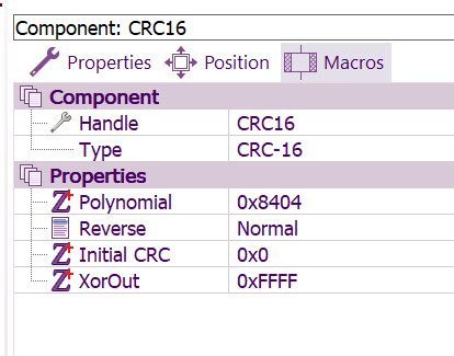

Hi Hermann,
First save the .fcpx file (from the first post) into a directory (for example c:\Flowcode)
Then add this directory to Flowcode's search using 'Build->Customise-Locations'
Okay I have G:\Flowcode (it's a long story - you're probably using C:\ )
Then you need to have your data in a byte array - I've modified your code to do this:
CCITT16-03.fcfx
(10.61 KiB) Downloaded 923 times
I;ve set the polynomial to 0x8404 - if you need to invert the CRC you can either change the value of XorOut to 0xFFFF
or use the ~ operator (and do .crc = ~.crc)
