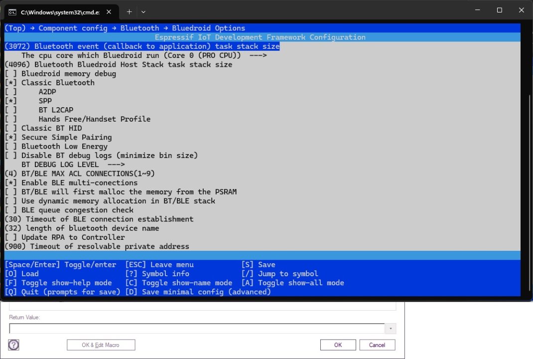

Double click this file and then in the window that appears, using the keyboard cursor keys go into Component Config -> Bluetooth -> Bluedroid Options.
Copy the settings shown here.

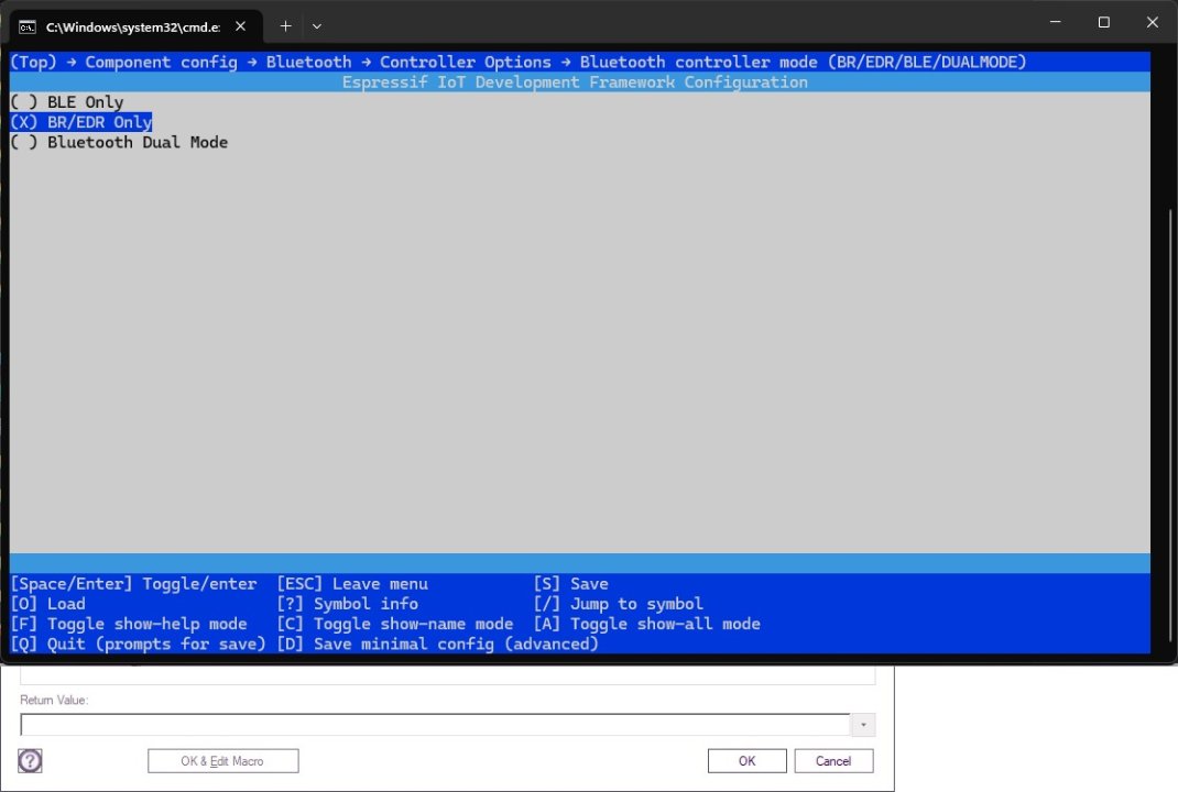

Once done here, press escape and go into Controller Options -> Bluetooth Controller Mode and change the option to BR/EDR Only.
Press S and Enter to save the configurations, then press escape several times to exit.
Hopefully Bluetooth should now work correctly in IDF v5 onwards.

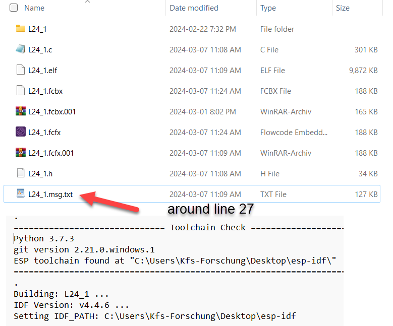

When i compile an esp32 project, several files are created. One of them is a msg.txt file.
It shows at about line 27, which python version and which IDF version is used.
Maybe we can see which combination works with bluetooth and which does not.
I had problems with Python versions higher than 3.7.3 for example 3.12 did not work with bluetooth
Info in msg.txt file:

This is my setup confirmed working.
Python 3.7.3
git version 2.21.0.windows.1
IDF Version: v5.1.1-1-gd3c99ed3b8 ...
