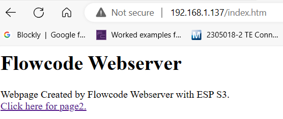

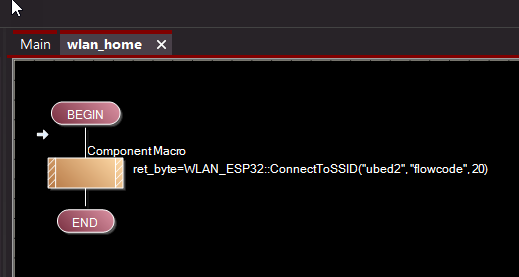

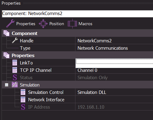

I found a way to build a webserver. There is just a problem with the display from the "link to"
Press the first time, the propertis is empty. Press a second time then you can choose the link.
Now I just need to use an additional socket connection to retrieve data with the App developper !
First time click there is no propertis to select: Second time click there is a propertis to select: set to your wlan: write the ip that you can see in the display Here the program for the Atom S3 diplay Link to the specific board:
