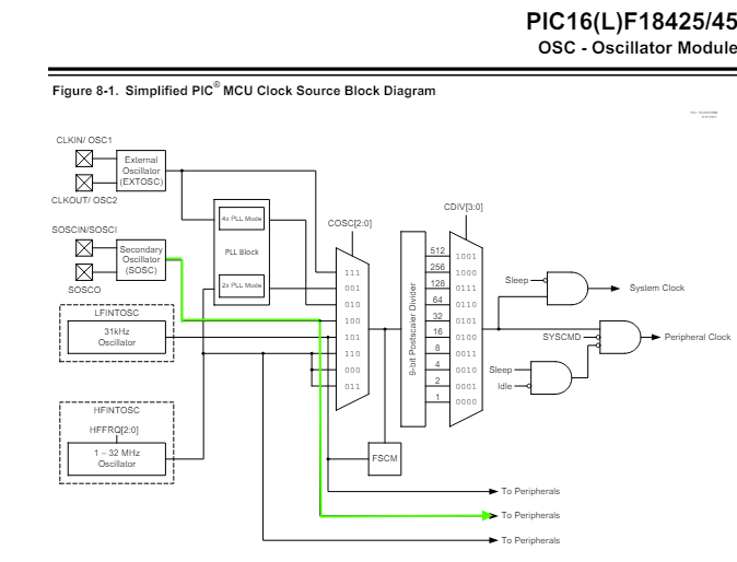

The reason I believe it will work is down to the green path:
I have not got your target device to check with, so I can't test if my answer is correct.
If it was me, I would set the project options for internal oscillator for your desired frequency, e.g 32MHz.
Connect the crystal and caps to the SOSC pins and then select the SOSC source from Timer0 interrupt only.
Hopefully, that will work.
If it does not work for you then you will need to check SOSCO for the correct frequency as you could have a cap mismatch?

I have tried just about every setting available! I think the confusion with the FC is that the SOSC uses the same pins as OSC1 & OSC2 so when they are off so is the SOSC.
The clock source block diagram has the SOSC has it as a separate input and block but that may just be a generic diagram.
