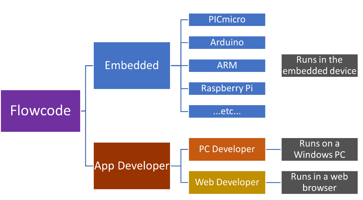

The diagram below shows the different types of Flowcode project now available and where each deployed project will live:
Flowcode Project Types.png (90.66 KiB) Viewed 29877 times
Note that once a Flowcode Embedded project has been created, it can be converted to retarget an alternative embedded device. Often this can happen without requiring program changes, especially when changing between similar targets (e.g., to a different PICmicro in the same family). However, an Embedded project cannot be retargeted to or from an App Developer project. Likewise, PC and Web Developer projects cannot be retargeted between each other.
PC Developer apps and Web Developer apps do not necessarily need to communicate or link with hardware. You could create stand-alone games or apps that teach mathematics. However, Flowcode users are generally interested in embedded projects and so both App Developer project types will often be used to interact with embedded devices.
