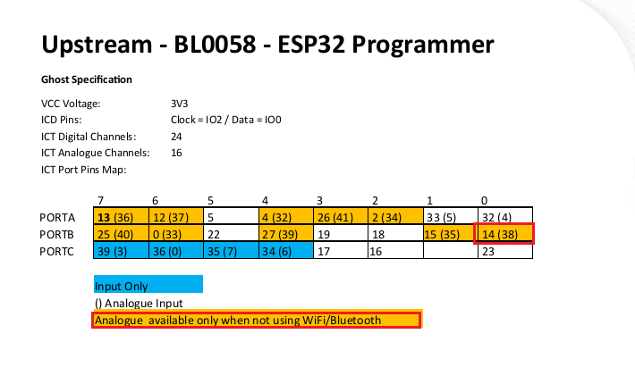

I have Just looked at the Eblocks2 datasheet for the ESP32 Upstream board.
On page 59 there is a diagram illustrating what ADC channels you can use at the same time as Bluetooth and WiFi.
You are using An38
Available ADC channels.png (48.6 KiB) Viewed 15998 times
On the ESP32 you get ADC1 (White background) and ADC2 (Orange background).
The issue will be WiFi shares with ADC2, hence there will be issues with ADC as WiFi will have priority.
This is from espressif inc.
To avoid confusion, the above espressif inc link refers to IO channels which are the channels NOT within brackets on the EBlocks 2 document, which was included as it shows the ADC channels within Flowcode.

Thanks for the additional info, I can confirm this was the issue. Further reading reinforces your post that all ADC2 pins are affected and cannot be used when either Bluetooth or WiFi is implemented. Moving my current sensing to a pin on ADC1 solved the problem.
