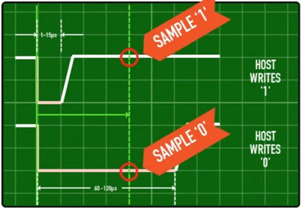

I stand to correction but I think
As in almost all comm protocols timing is important, although 1 wire dose not have a specific baud rate
it relays on timing to distinguish from 1 to 0 , timing is in us so I guess it wont be possible with an MPU running at low frequency
2024-06-17 16 18 14.jpg (40.68 KiB) Viewed 6143 times
Thanks for your help I will look for an Alternative .
