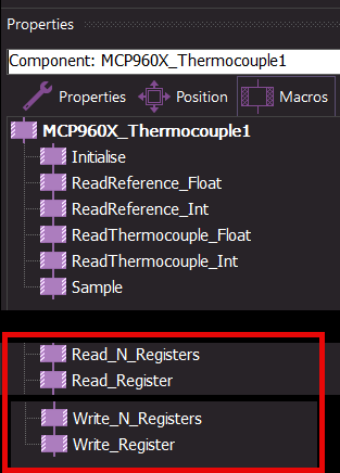

Would it be possible to add read write registers commands like the others I2C components?

Can you see if the attached works for you.
MCP960X_Thermocouple.fcpx

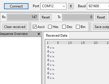

I set in register 5 (SENSOR CONFIGURATION REGISTER) to value 6 (Filter Coefficient) then I read the register 5 and send it to USB C.
Even if i use two I2C multiplexer board it's working nice.
Program:
result in a terminal program:
