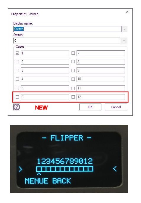

SWITCH with 12 decisions.jpg (49.96 KiB) Viewed 13332 times
You see one oled screen with 12 possibles inputs you can choose. There are other screens where you can choose 12 inputs again. The program must know, where you are actual standing on the screen. To split into 2 varables is more complecated.

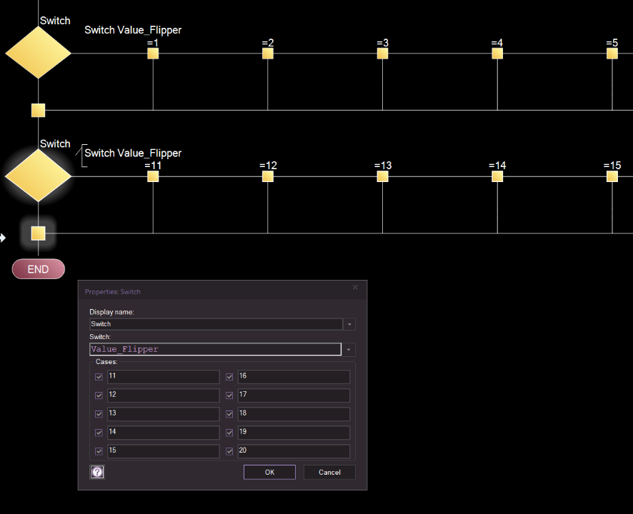

Re: Switch with more decisions
Hi Jorg
You can use the same variable in the switch.
You can also create 2 switch witch 6 position just choose the nummber.
it also has the advantage that the icon is not so wide
switch with 20 position
