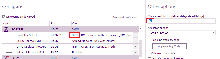

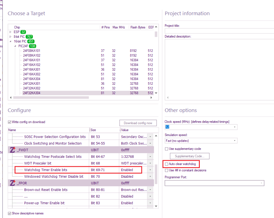

Can you compare FC10 Configuration Options to FC6.
The reason I mentioned the 1 sec flasher is because you have Watchdog Timer Enabled set to yes, but you don't add C code Command icon or Autoclear watchdog enabled in Other Options, to clear the watchdog timer. That would mean your hardware keeps resetting and not allowing the LCD to work.
Also there looks like there is a mismatch between clock speed selection and Clock settings without a C ocde block to change clock speed on your hardware to match: I'm surprised that the LED you have connected to your hardware cycles on and off at exactly one second.

Sorry I had changed the watchdog settings as you last suggested but still no joy and also changed the clock time.
Thanks, John
