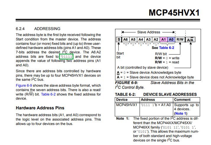

If the fixed address was 0x38 then it would be 01110 instead of 01111, unless the datasheet is wrong?
Anyway, I will try as per datasheet, and if that does not work I will change the address to 0x38 instead.

The datasheet for MCP45HVX1 shows: Therefore the fixed address should 0x3C and not 0x38

Re: Component Digi-Pot MCP45HVX1
It must be address 38, as the original MCP45XX MCP46XX component has 1 more variable address, bit 3 with the value 4. 0x38 + 4 = 0x3C. I therefore always had to set address bit 3. Then the addressing was correct. Of course it was just a workaround and worked well. Now it is as it should be!
