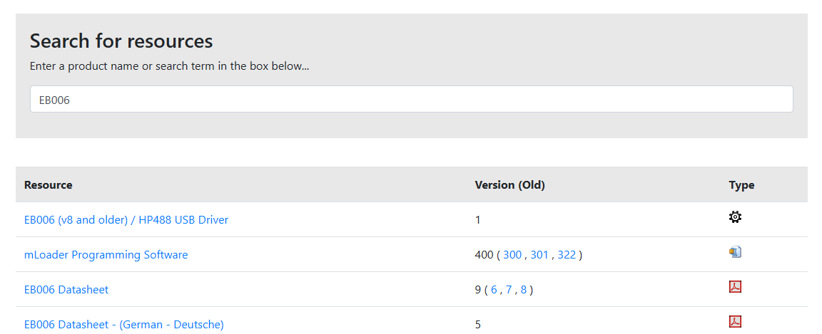

OK so I have an EB-006-00-7 multiprogrammer board with various E blocks. I still want to make use of this. Could someone point me to which drivers I need to download and any other set up information I need.

This is the page you need:
https://www.flowcode.co.uk/old_site/resources/
Just type EB006 into the "search for resources" box on that page and the old drivers will appear at the top of the list.

Thanks for this Steve however when I click on the V8 or older link I cannot see any drivers

It should be showing as the first entry in the list.
You will need to press enter after typing EB006 into the resource search box to activate the search.
Clicking the link should download a zip file to your PC. You need to unzip that file and run the appropriate driver installer (probably the 64-bit one).
There should be an FAQ about this somewhere. I'll see if I can find it.
- eb006 driver.png (32.06 KiB) Viewed 3200 times

This faq might help.
https://www.matrixtsl.com/faqx/index.ph ... artlang=en
