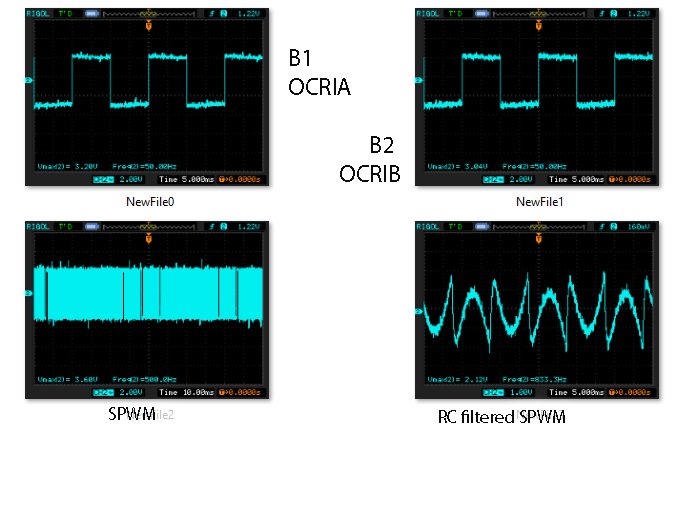

I added to the main loop the output to flash the onboard LED (B5).
It does not flash.
For some reason the main loop is frozen.
However the converted by you code works and Timer1 works OK in mode8.
I can be wrong, but I think, the next can be done:
- lut and main loop problem should be solved.
- improve the dead time code.
- create the mechanism of changing the value of Timer1 ISR1.
I think, when ICR1 = 800 the sinewave value is close to zero or zero.
The code line: OCR1A = FCV_LOOKUP * 0.7 + FCV_DTA should be changed as well.

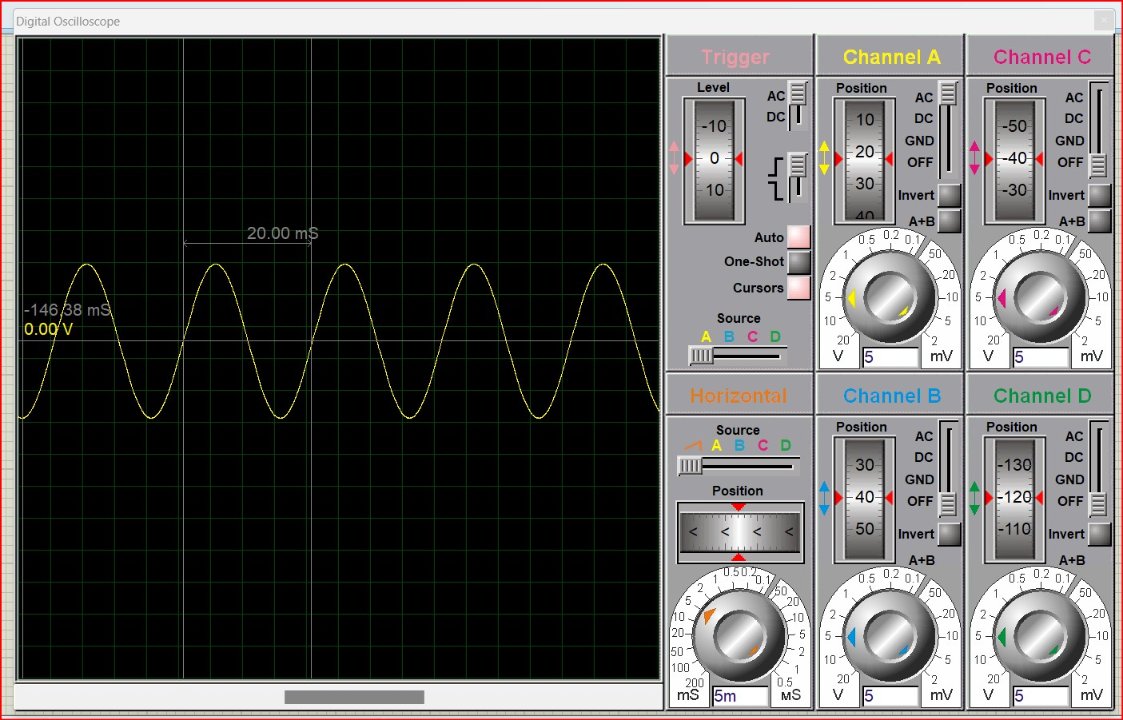

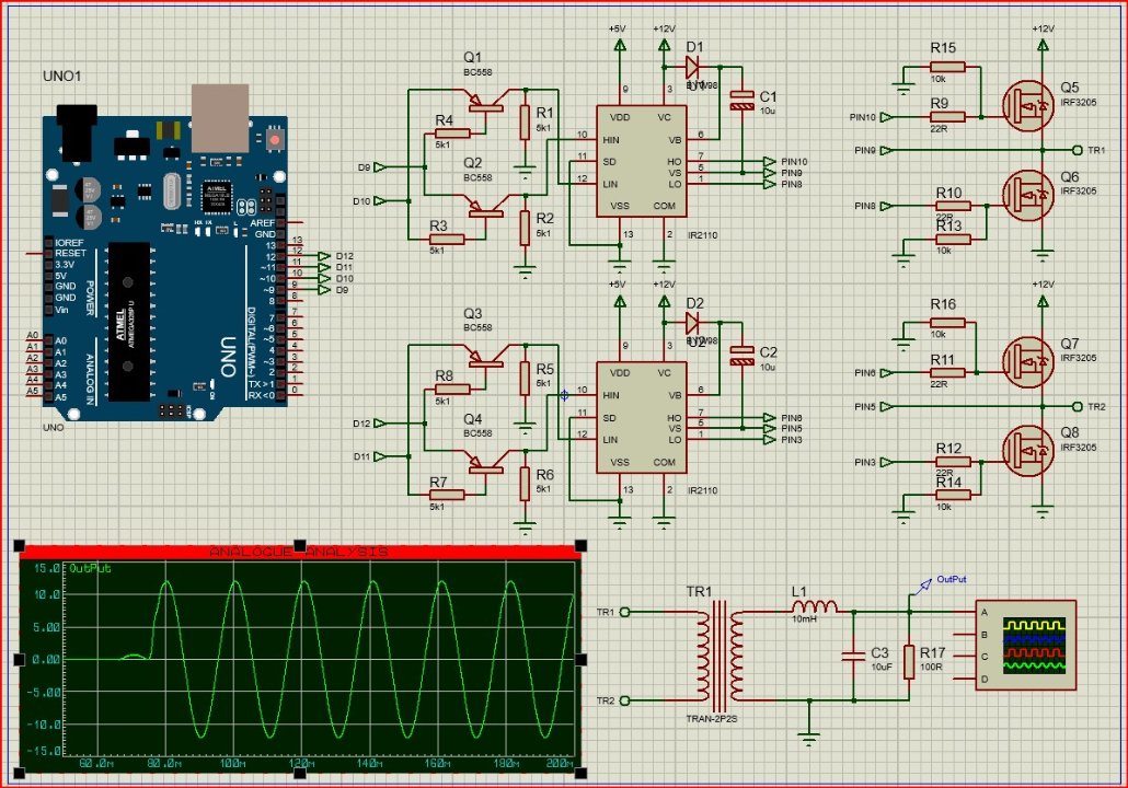

i had draw the the circuit in proteus as same as in article ( i don't have full hardware to test it in real world) if you have hardware you can test it.
proteus simulation is working well as attached.
About the fixed voltage correction value = 0.7 is an Example it can be change as you wish, 0.7 will give 70% of each LUT value.
Eg: 0.5 will give 50% of each LUT value , 0.9 will give 90% of each LUT value.
it can be use to vary the output voltage or stabilize the output voltage use feed back from output.
you have to use a variable instead of fixed value.
Correct me if I am wrong?
in this case Lut value 0 will give always 0% duty cycle and 800 will give 100% duty cycle without voltage correction value.
adding different voltage correction vale will allow to control output amplitude.
