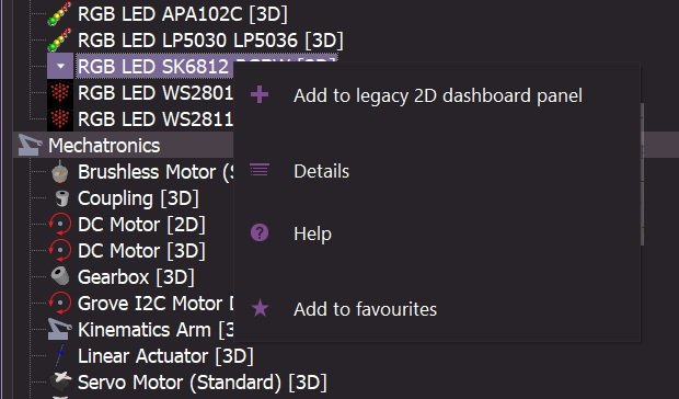

This is what appeared when I left click on the component: "Add to legacy 2D dashboard panel".
But it put it on the Panel.
Thanks for the help. :D

This is interesting. I see this when I right click on it.

In File > Global Settings... > Application tab there is an option to Disable the 3D system panel
Have you got that ticked?

Yes, that was the problem. The 3D Panel was not enabled.
Thanks again.
