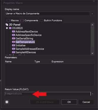

Hi Carmelo,
First you need to Link the DS18B20 component to the One Wire component as below:
Next add your variable 'Temperatura' to the Return Value :(Float) under DS18B20 Component properties:
It is also good practice to Initialise the One Wire component.

Fhanks for the response.Arix wrote: ↑Sat Mar 22, 2025 7:40 amHi Carmelo,
KR
I knew about the float variable but I forgot and I didn't know about linking the bus to the sensor, hence the question.
C.
