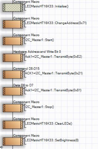

Re: HOLTEK HT16K33 setting Slave address Progmatically
So this DIY initialise seems to work for a single IC. With a manually set address 0x71 + Write = 0xE2.
I have to use the Change address macro at the start so this Macro is clearly setting the correct Address to the rest of the FC code. So.. even if the Slave Address is set to another number in the Component Properties, this INIT it still work. Which is good.
If the INIT is run before the min loop, all is Good.
But If I try to run it inside the Main loop, the LED status Blink slows to a glacial crawl and there is no I2C output measured by the scope.
I hoped I could just initiallise each IC every time i wanted to write values to it, that currently does not seem to work. J.

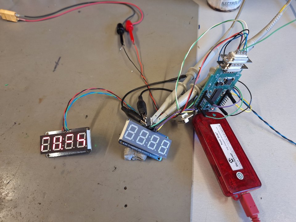

Hi, I have a simplified hardware setup on the bench to remove any possible hardware issues. Just using 2x Adafruit 7 Segments with Holteck Backpacks.
I can write indiviidually to both modules, one is i2C address 0x71 the other is 0x72
However I cannot 'hot-swap' between the two. When I enable the change address macro, the i2C comms is stopped.
Monitoring with the scope, I get the initial setup i2C messages but it does not transmit any of the Change Address i2C commands.
Program is still cyclcing (very slowly) but no further i2C commands are issued.
I tried to write my own initiiase for the HOLTEK, whilst this works OK, it does not set the correct Chip address in all of the other Macros so no other command will work.
I dont know how to set the I2C hardware address so that all other macros of the component write correctly with the new address. Any thoughts on other things I can try is appreciated.
J.
