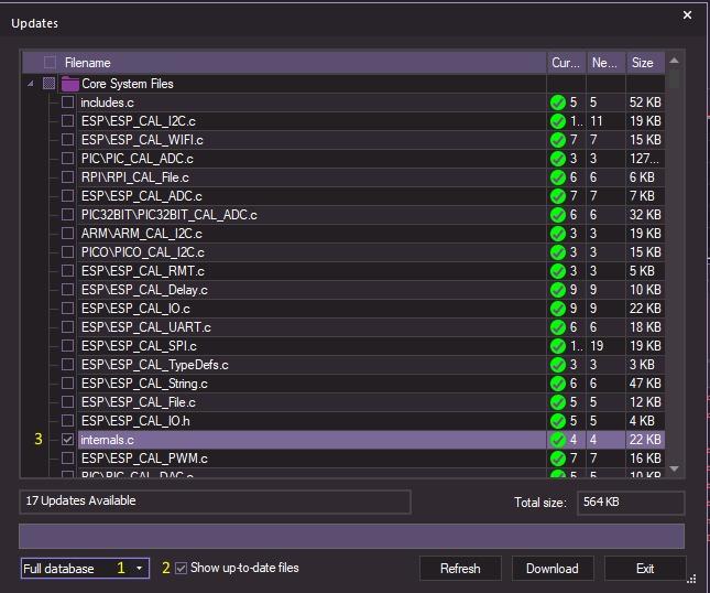

Hello Dear Flowcode Family
The software was compiling until today morning, but when I made the updates that came today, I started getting a compilation error. How can I see the library changes you made today?
Everything was working normally until the update.
Sadık

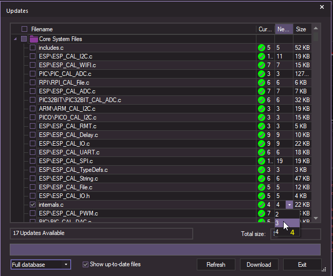

As there might be more than one person , including beginners, so I will use images to show how to rollback.
The steps are in yellow on the images.
First select Help > Library Updates...
Then Step 1. Change Files in-use to Full database
Step 2. Click on Show up-to-date files
Step 3. Only click on Internals.c
Step 4. select the drop down arrow and change the revision from 4 to 3
Step 5. Click on Download
Now the Updates window can be closed and then reload your project.
