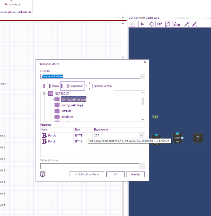

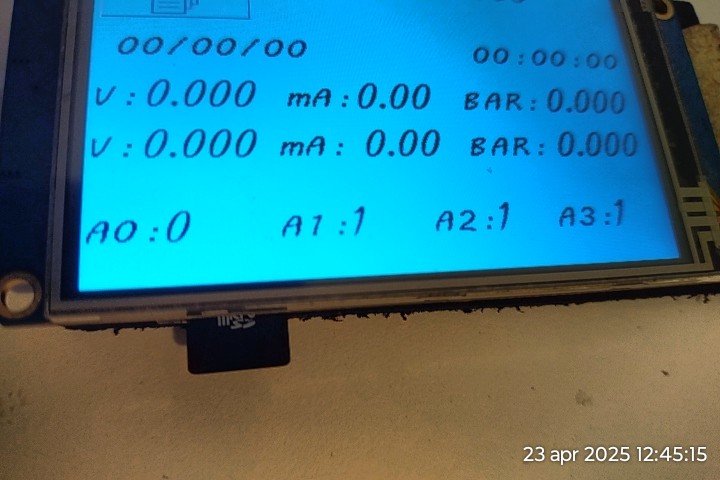

HI, I'm trying an MCP23017 to expand the inputs, I noticed that when I use the ConfigureInversion function only A0 inverts the logical state from HIGH to LOW, to do some tests I only connected the first 4 inputs, as Hardware everything seems fine the inputs are all HIGH and when I close the contacts corresponding to the inputs on the display I see the change of state. Is it a problem with the FC component or do I have to look for something in my HW?

The tooltip shows you will need to set an 8 bit value.
What happens if you set the port to 255, that should enable all pins to invert.
Likewise a value of 1 should only set pin 0 to invert, a value of 2 should only set pin 1 to invert.

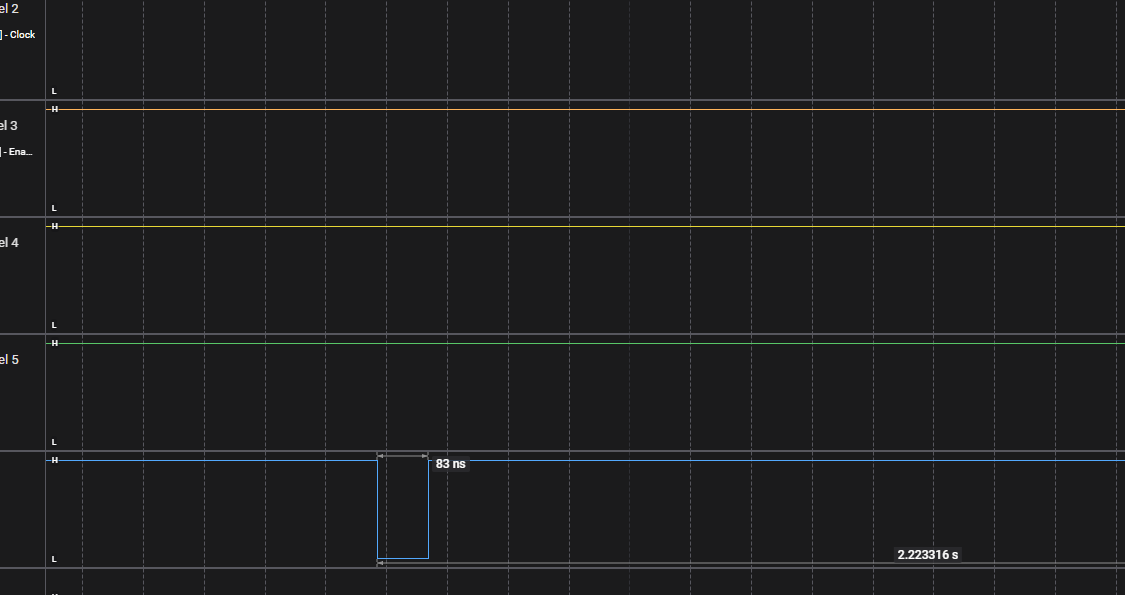

Ok thanks Martin it works I was misled by the description of the parameter that indicates 0 or 1, I take this opportunity to ask you another question about the component and precisely about the use of INTA and INTB that in the idle state are in the HIGH state to switch to the LOW state when the 23017 detects a change in the input of the pins, what I saw with an analyzer is that this change of state is very short and is not detected by the interrupt pin of the micro that I use (stm32f411) is there a setting to set?

The interrupts are level based and not pulse based since reading the port should then clear the interrupt.
There is not a register that can slow down the interrupt function.
Have you tried timer based interrupt captures?
I'm not sure if I can help much further as I don't have a stm32f411 to test with

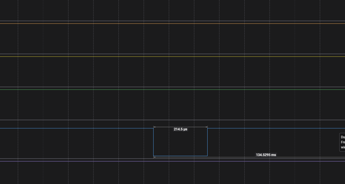

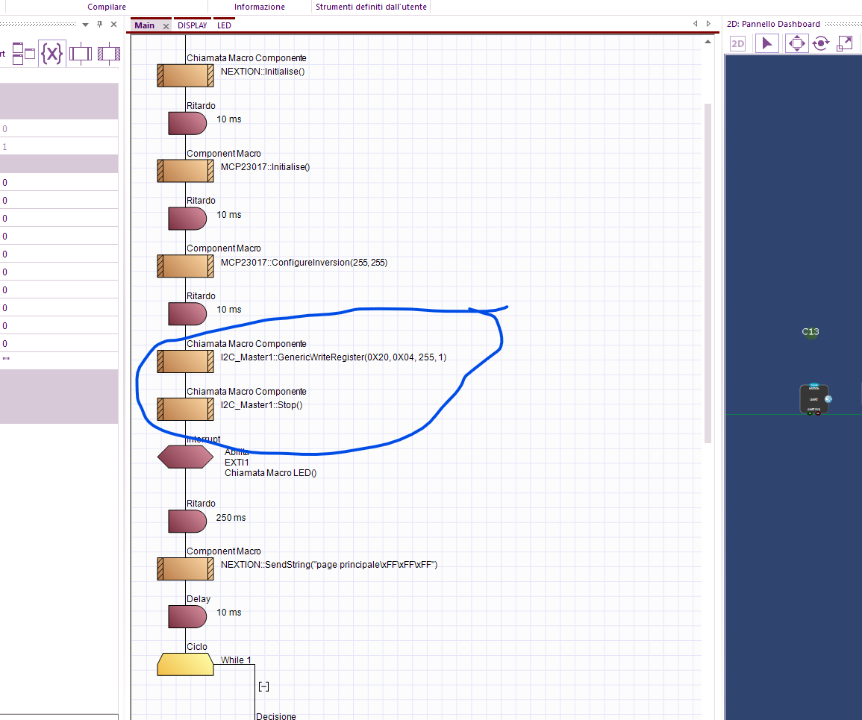

HI, if it can be useful to someone I managed to activate the INTA interrupt by modifying the GPINTENA register at address 0x04, inserting 255 modifies all 8 inputs of portA, (verified and it works) if you also need it on portB you have to modify GPINTENB at address 0x05 (I haven't tried this yet), I set the interrupt input of the micro as descending, now the amplitude of the interrupt exceeds 200uS and is sufficient to be detected
I ask Martin if he can take a look at the code to see if it is configured correctly and for improvements

Thank you for that, I believe I know what going on.
0x04 is the interrupt enable for portA
If you write to 0x05 is the interrupt enable for portB
What I have done is modified the component.
I have added two extra functions.
ConfigureIOC()
& ReadINTFlag()
With the latter you can read the interrupt port A or port B to deturming with pin/s triggered the interrupt.
I have added masking , so you don't need to.
I have also modified the tool tips to make it clearer what values are required.
Before adding to the component database, can you please test the component and see if it behaves as expected?
