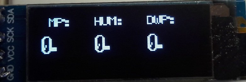

I am using an SSD1306 display with a PIC24FJ256GA702 MCU.
It works fine with Flowcode9, but the displayed content is incorrect with Flowcode10.

Many thanks for reporting this.
As a temporary fix can you rollback the SSD1306 to version 13.
Reload your project and try again?
The instructions for rolling back can be found on the wiki here

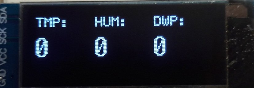

Re: The content on the SSD1306 display is displayed incorrectly.
Post by Sasi »
:D Thank you, that works well. :D
