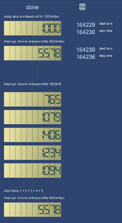

I wrote a small App to check delay time and Interrupt time.
The delay is really nice. For 1 Sec I get 1000mSec. Not so good is the Interrupt. I get a lot of different times so I checked 5 times the value.
Each value should be 1000mSec and all together 5000mSec.

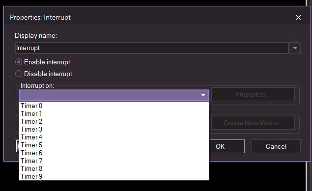

I would defiantly not use an interrupt with App Developer.
There is a much more accurate way to obtain time delays.
Take a look at this topic

I just tested both command icon, how exactly these work in the App developer. When I tested the delay, I wanted to know how many milliseconds of deviation it has. When I tested the interrupt, I wanted to know what frequency deviation it has. Since I noticed that the frequency very strongly wobbled with +-20%. This does not make it possible to determine the frequency. This interrupt works well on my computer and otherwise and I need it for the DSP components. These DSP components don't care if the interrupt wobbles . :) The DSP components still deliver the correct values and filter works correctly (maybe). Only if I control the recording duration and sample rate I get strange result. I hope there is a way to make the interrupt in the App developer stable

I've made a note to investigate this, but I have a few other priorities at the moment and so I don't expect this to be fixed soon. So for now you may need to find an alternative way of timing if the interrupt method is not suitable for you.

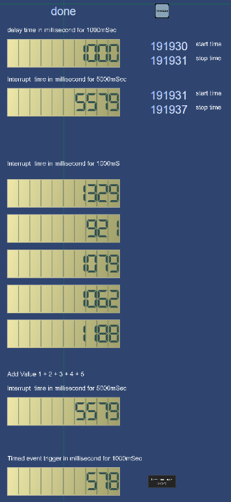

So I included the time event trigger in my test. But that acts the same as an interrupt!
Varible result and instead of 1000 milliseconds sometimes only 578 milliseconds
I am not sure if I did all this test correct. But it cannot be compared with a Swiss watch :)

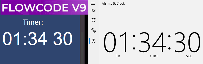

The time will count every second from -5
Use a stopwatch and start it as soon as seconds reach 0.
Leave for a period of time, e.g half an hour.
Then compare stop watch with the time elapsed on the display.
Timed Event Trigger Seconds Test.fcsx
(17.09 KiB) Downloaded 796 times

With your program everything works fine, I let it run about 94 minuten (still running) and less than 1 second difference
So I will check whats wrong on my stuff.
