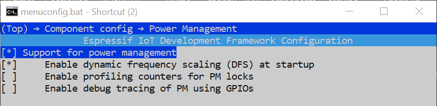

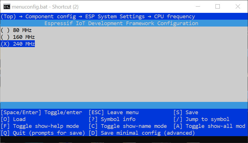

In the menueconfig I can set the clock to 80Mhz,160Mhz,240Mhz with the result that power consumption is reduced.
However, this applies to all boards with the same ESP32

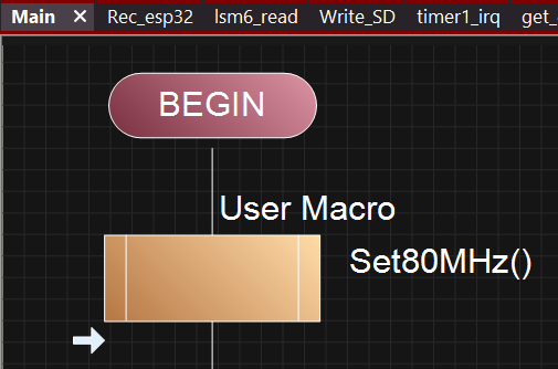

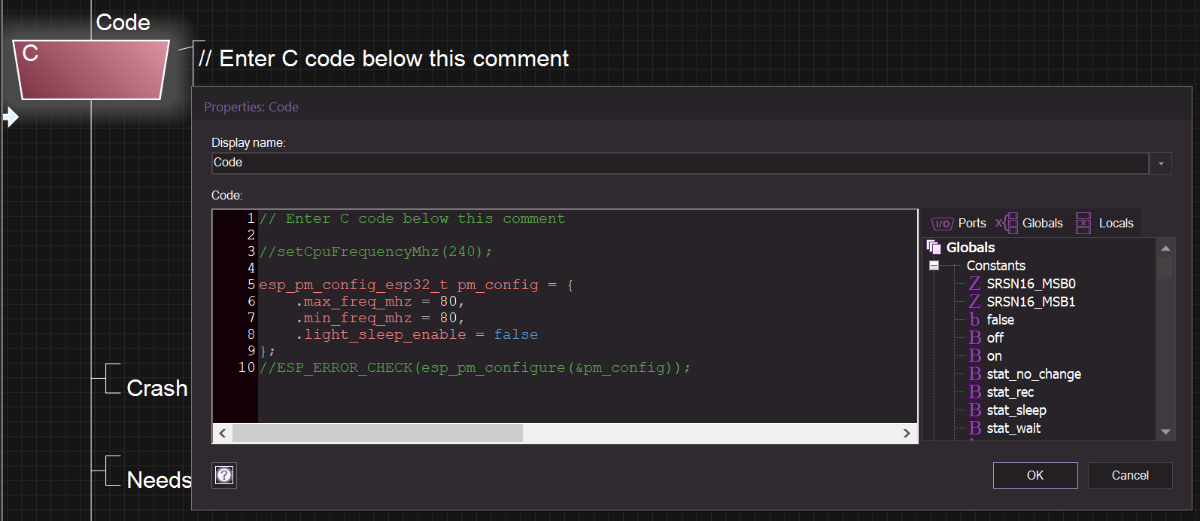

It is also possible to make the individual clock with a C-code.
I have tried, there is no error but the clock is not changed either
Menu working:
C-Code in main:

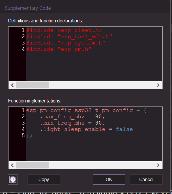

Supplementary Code:

esp_pm_configure(&pm_config); 'should' do this. I've tested - and you need to have power management enabled in menuconfig (component config/power management).
Note that delays should still work correctly (this is handled by RTOS)
I use 5.3.2 - and esp_clk.h is now 'private' - and may disappear. Location may be different (see supplementary code)
Allowing light sleep (set to true in Set80MHz) - seems to stop the clock changing.
The output - shows clock before and after change:

Ok I have tried but a small error...
idf/main/CMakeFiles/__idf_main.dir/esp-project.c.obj -c C:/Users/stefan.erni/Desktop/esp-idf-2/mtxesp32s_sdkconfig/main/esp-project.c
C:/Users/stefan.erni/Desktop/esp-idf-2/mtxesp32s_sdkconfig/main/esp-project.c: In function 'FCM_Set80MHz':
C:/Users/stefan.erni/Desktop/esp-idf-2/mtxesp32s_sdkconfig/main/esp-project.c:2268:3: error: unknown type name 'esp_pm_config_t'; did you mean 'esp_netif_config_t'?

There was deprecated struct - this must be only available on later versions🙄

I don't have anything less than 5.1.4 (and BT are running in treacle tonight) - but try changing the struct from esp_pm_config_t to esp_pm_config_esp32_t
Otherwise hopefully everything else would be the same?
I tested using 5.1.4 (the earliest I have installed) and it does work - using the older struct name. However - the 'change' in clock speed doesn't take place until the MCU has an idle section - this is easily achieved by adding a delay....

Perfect! It's working nice.
It is very comfortable to use. Just import the macro and place it at the begin.
If you need to test with 240Hz just toggle disable the macro.
With this setting my recorder runs twice as long on one battery charge :)
