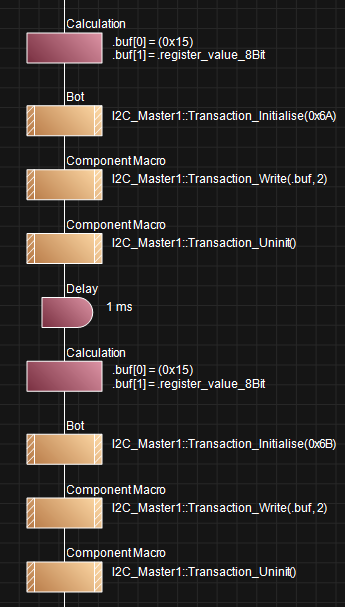

Sorry , I just noticed that you got the wdt issue when writing to i2c in a loop (I hadn't read it as 'just' writing to i2c in a loop at the beginning)
That make it even stranger :-(
Posts: 1300
Has thanked: 246 times
Been thanked: 258 times
Re: ESP32 read i2c or i3c in IRQ macro
Hi Martin
Yes, that too: In an almost identical program this works perfectly. I can also write to both IMUs.
Posts: 2185
Has thanked: 177 times
Been thanked: 1026 times
Post by mnfisher »
I didn't get an issue with the above example - just multiple writes to i2c as expected.
So what changed?
I notice a comment about the RGB LEDs initialisation not working in a macro too - more weirdness...
Posts: 1300
Hi Martin
My program works again!
I can set the LSM6 with I2C master and I can read LSM6 with I2C master
I had to set all I2C components to ch2!
With almost the same program on I2C ch1 it works fine...
Thank you very much for your support Martin.
