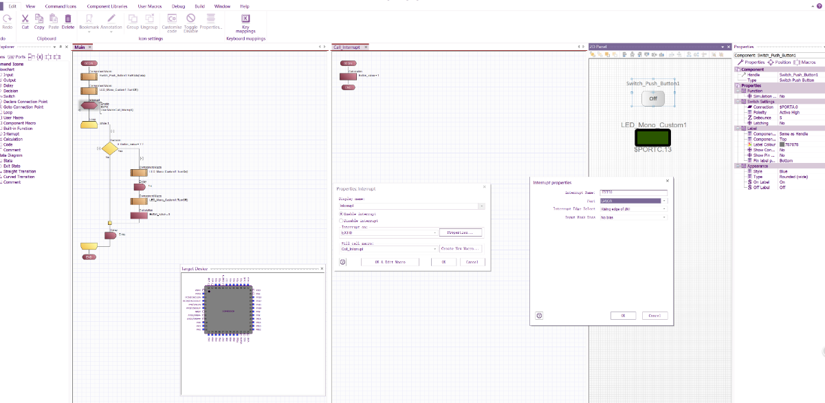

I couldn't even achieve the EXTI Interrupt software simulation in the Debug - Run mode.

To be clear, only STM32F411CEU6 I have downloaded it to a standard development board(Still failed), for the others, I only tested it in the Debug-Run mode. the program will never goes into EXTI macro even when I set the EXTI active button always on and Step into it.
As you mentioned,I changed the program to use a flg in the EXTI Interrupt Macro and an LED on the main loop.
I have tried 4 boards : ESP32(OK),PIC(OK),PICO(NG),STM32(NG). 2 success and 2 failed. The program are all same except the Interrupt pin.
If some want to check, please see below attachment.
I think Flowcode developers should pay attention to this issue.
Or prove me stupid. I still think this is a good example for Flowcode beginners, and I believe there will be people who encounter the same problem as me.
BR, Deqiang

I have replaced the replaced the file"32F411CE.fcdx", have tested the sample project "STM32F411BP_LED_EXTI.fcfx", have finished the component library update.
To be honest, I didn't find any difference, is it all be tested? Is there someone really trigger the EXTI Pin and saw it jumping into the EXTI Marco in both simulation mode and real board?
I have recorded the screen and try to show them, but it is too big to be uploaded.
Sorry, I don't know what else I can do for it. Now I am using Flowcode V10, maybe you are working on V11, but please make sure they are tested on V10 and working well.
