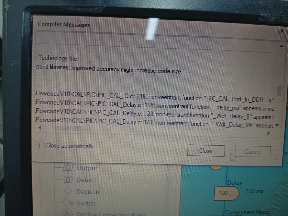

I'm compiling another flowchart and it showed four messages that hadn't been presented.
C:\ProgramData\MatrixTSL\FlowcodeV10\CAL\PIC\PIC_CAL_IO.c: 216: non-reentrant function "_FC_CAL_Port_In_DDR__x" appears in multiple call graphs and has been duplicated by the compiler
C:\ProgramData\MatrixTSL\FlowcodeV10\CAL\PIC\PIC_CAL_Delay.c: 105: non-reentrant function "_delay_ms" appears in multiple call graphs and has been duplicated by the compiler
C:\ProgramData\MatrixTSL\FlowcodeV10\CAL\PIC\PIC_CAL_Delay.c: 128: non-reentrant function "_Wdt_Delay_S" appears in multiple call graphs and has been duplicated by the compiler
C:\ProgramData\MatrixTSL\FlowcodeV10\CAL\PIC\PIC_CAL_Delay.c: 141: non-reentrant function "_Wdt_Delay_Ms" appears in multiple call graphs and has been duplicated by the compiler
Compilation successful!
Using <PICKIT3> user settings for linker
C:\Program Files (x86)\Flowcode v10\tools\DoNothing\DoNothing.exe
FINISHED

In fact, I just compiled a finished flowchart that didn't show that message. I compiled it and it also showed that message, which wasn't present in compilations prior to 2 or 3 days ago.

This is a published example that outputs 1 message.

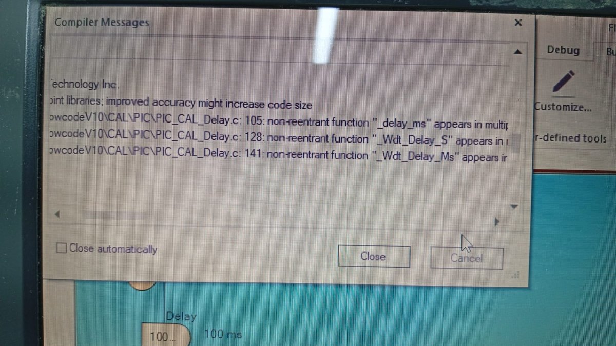

I just updated with patch 10.1.2.40 but 3 messages continue to appear. A few days ago none of these messages appeared in that same flowchart.

I don't know if these messages affect the correct functioning of the program in any way. :?:
